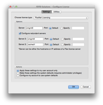

FlexNet Licensing
This is a mechanism [1] in use for Lumerical version 8.6 onwards. To use your Lumerical desktop version, follow these steps:
When inside CNM or using VPN – does not apply to Carbon
- Verify that you are inside CNM's network by browsing to http://carbon/
- In the Lumerical License configuration:
- Choose license type: FlexNet Licensing
- Activate: Configure redundant servers.
- Set Servers to
cmgmt3orcmgmt3.cnm.anl.gov, cmgmt4, and csched1.- The "About" menu entry will report a lengthy string.
